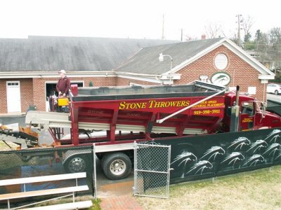

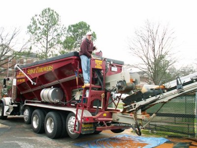

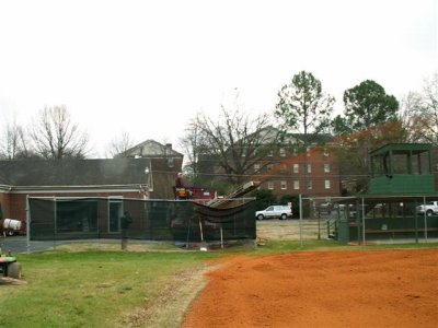

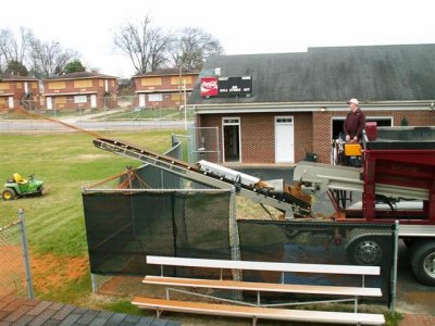

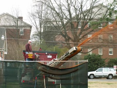

  10. WndMillR
    In Raleigh.... heres the ticket
    Bradsher.... up in Wake Forest....They will provide a mix, usually 70-30 clay to turface for your playing surface.
    We put 30 tons on my field 2 years ago....
    This is the way to spread it....
    see pics
